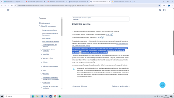

All batteries replaced and software updated but still losing 10% every 2 days when van is not in use
