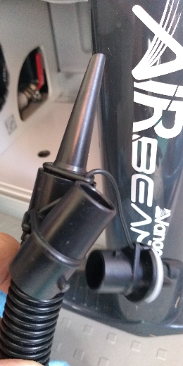

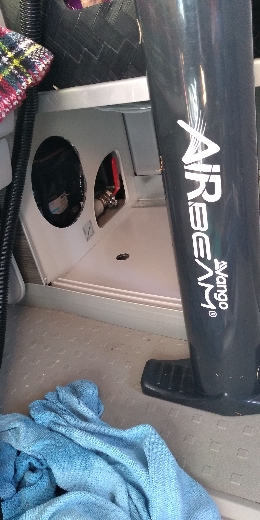

Another scenario happened this week, drain blocked, closed drain valve, took off overflow above T piece, opened valve slightly and water coming up T easily so block must be 'downstream'. Closed valve and used my Vango airbeam pump with provided attachment to insert in top of T and one pump cleared it, chuffed! Reattached overflow loosely to test and fully opened valve, flowing better than ever. Must have picked up some mud or debris at outlet.
