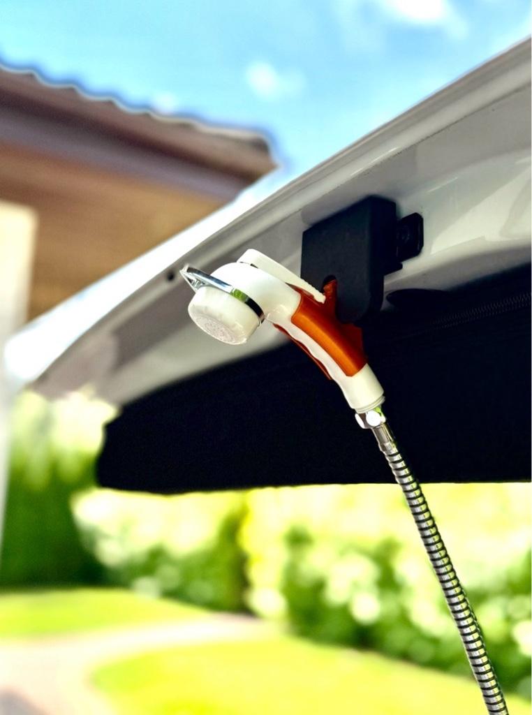

Tailgate shower holder
For T6.1, may also fit others.
https://makerworld.com/nl/models/16...t6-1-tailgate-shower-holder#profileId-1787856

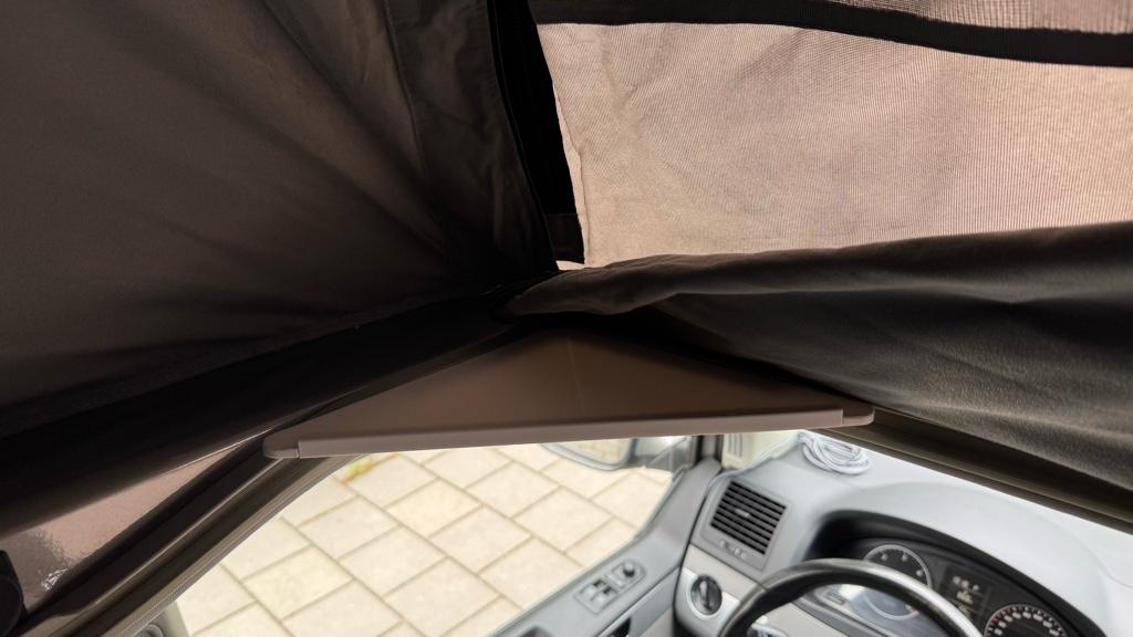

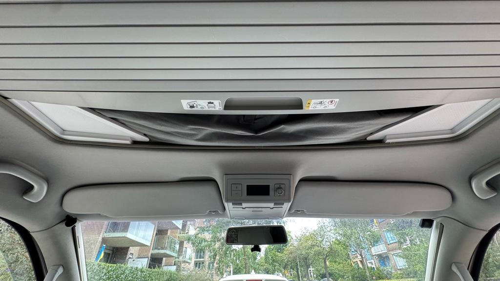

Very nice, thanks! I actually printed the upper bed shelves in that collection this morning
Oh - awesome - I thought it will not fit when the roof is folded, but it seems it does - which is great as I dont have to figure out a place to store those :)
It fits, I even have a Brandrup Isotop inside. The only thing is that the slide can’t fully close as you can see in the picture but that’s not a big deal.

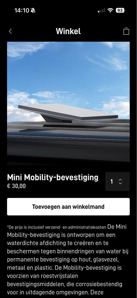

Honestly, you are better off just buying the mobility mount from Starlink and mounting with slot bolts to the rail. I did just that, but with a high roof van attached to airline rails on the roof.
Not the cheapest but maybe the best guarantee for success indeed.
In the
In the Starlink Shop in Switzerland it's 12 Chf. I can't even buy lunch for that. Alternatively if you have low profile roof racks you can use the Mini Roof Rack Mount for 16 Chf. I'd say those are cheap.
In the
This is what I see in the Dutch Starlink shop, but this one of officially meant to be mounted through the roof, not on the rails.
It’s meant for that, but as it has bolt holes nothing stops you from using those with bolts to airline rails or other rails like on a Cali. I just used my own airline rail bolts cut to size and drilled the holes slightly larger to fit the M4 bolts. Works perfectly. My dish is going nowhere. I driven at 130Kmh with 30-50kmh side and headwinds and it was rock solid.
