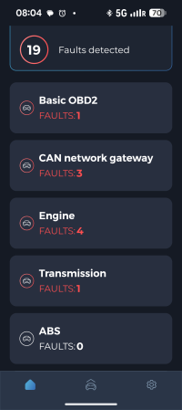

    It's now aug 26 we are in Europe and the same thing has happened again, red battery warning. I've taken the van to two VW dealerships...
