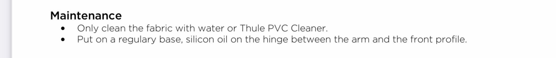

Edit: try some silicone spray to the nylon washers and the arm pivots (do not use oil as it will stain and hold dirt )
