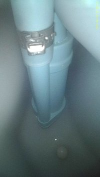

You’ve motivated me to stick the scope in the tank and see if all the water drains out when you open the tap. If the pump is mounted at the bottom I’m hopeful it fully drains out.
For those that are interested this is the bottom of the water tank - I now understand how it works.
The tube at the back looks like it’s a plunger, so when you open the tap at the top it raises the plunger and drains the tank. Which gives me confidence that when you empty the tank it fully empties.
Second image is the submersible pump. Which I think shows that you need to run the tap until it runs dry as the pump seems to pump up and along to the tap.

I’m with you, everything I have ever learned about water pumps is not to run them dry. However, I think the handbook says you can run these pumps dry to clear the water, I suspect they have been designed to run dry as there is no water gauge. I just wouldn’t run them for very long.
The VW pump is made by a company called Comet, all their 12v immersion pumps state they can dry run for up to 30 mins.
