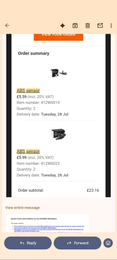

One of the Wheel speed sensors is failing.
Scan tool or dealer could tell you which one, but i would recommend changing them all anyway.
Lots of posts on how to do them yourself in this forum.
