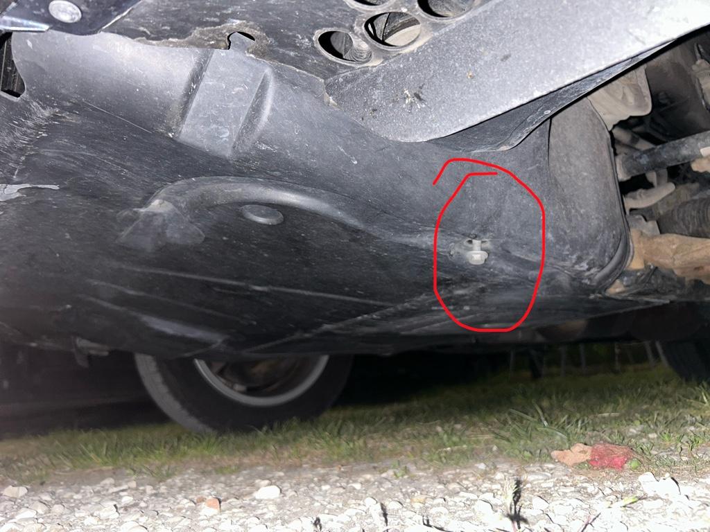

We have been traveling from Southern Sweden to Venice for 2 days and have started to feel some vibration and noise at the left front wheel 50 km before the finish line. We checked but saw nothing so we continued to Venice.
Now I see that a screw under the vehicle is loosed
(see the picture, I have marked it in red for better understanding).
So it concerns a 2019 T6 with 204hp 4motion diesel.
Is this something you have seen?
Any idea what it could be?
The damage has been reported to the insurance but of course it is Easter weekend now…
Grateful for all the help and tips!
It looks to me to be one of 6 M8 bolts holding the engine under tray on. Get a 13mm spanner and tighten it up.
No big deal.
Under tray bolt, (one of about eight) simply tighten it up
