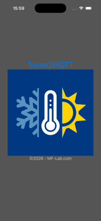

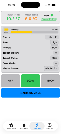

Good morning everyone,
I'm developing an app for (for the moment only for IOS) capable of controlling the Truma Combi (any version) remotely (3G/4G/5G).
I should be able to publish the app in the APP-Store by the end of February... (I'm alone, I ask for your understanding).
The APP interfaces through a Raspberry PI Zero W2 (about €15). and a small "LIN to UART" interface (about €5).
I will prepare the "complete package" to download and install directly on the Rpasberry along with the release of the APP.
I wanted to know your interest.
Thank you and have a nice day
Marco
PS: you will find everything here in my GitHub
https://github.com/mk4001

Looks very interesting. I remember an earlier post on this and at the time I did buy the RPi and LIN interface which are now in the 'future projects' box waiting for some spare time to have a closer look. I would imagine there is a good amount of interest in this but perhaps as a more turn-key solution (eg a set of instruction on how to configure & install the RPi set ). There were questions a few days ago on the UK FB group on this topic.
I was also looking into this from a Home Assistant perspective - an app would be a neat solution so consider me interested!
Question for you Marco - what's the plan for remote access to the RPi? I expect you'd need a AP on the van for it to operate e.g. a VW Connect+ subscription, or a 5g modem/router.
Also is this LIN only or is there CANBUS connection?

Good question RoamingHoming,
thanks for asking: sure a small general purpose 4G/5G portable or fixed router is required onboard in order to permit remote access from GSM network.
I use an old D-link portable one; price starting from just 40.- GBP...
have a good day
Marco
Sorry, missed the second question: LINbus right now, CANbus will follow on next release....
One More Thing: BLE connectiviy is on the way... No router needed if used onboard...
You need a router if you want to extend the connectivity when your're abroad...
