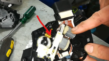

New lock or strip the lock open and change the drive motor.
I've did 3 or my Landrover, and 2 on the Volvo....a colleague has had 2 locks changed on a VW Beetle. Common problem.
The last one I changed the motor at £11 in lieu of a £200 lock. The lock used to be circa £90 in 2017
