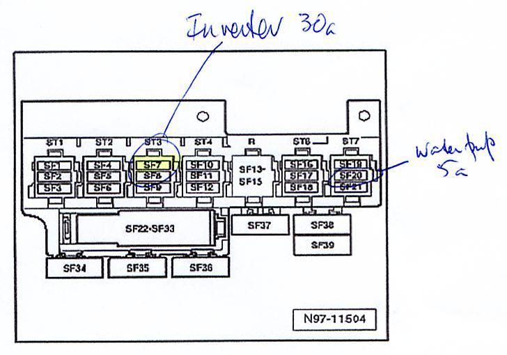

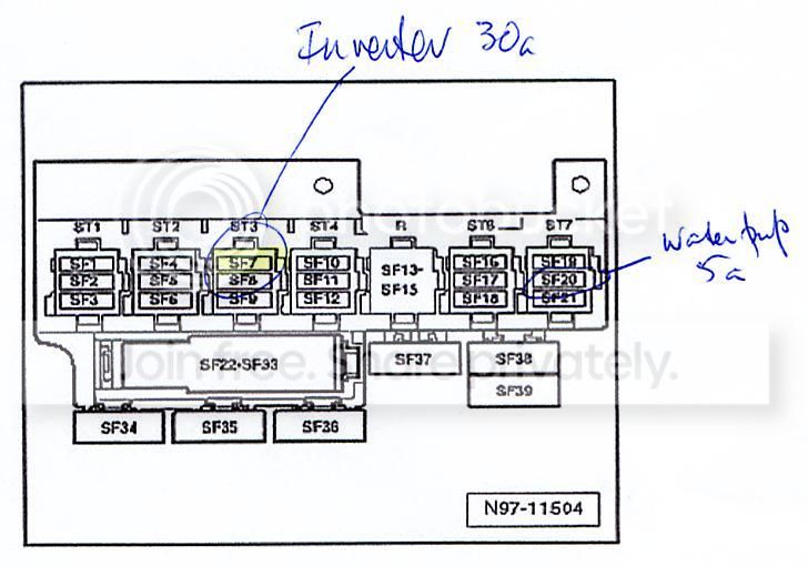

On my 2013 LHD Cali, the inverter fuse is SF7 under the driver's seat (LHD...).
Seemingly fuse locations can vary!
