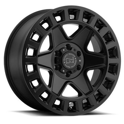

They’re not for me but these Black Rhino Yorks are going for a good price (in comparison to other sellers) in case anyone’s interested:

please, what's the name of the 2nd rhino, as I am not able to find it on their site?
