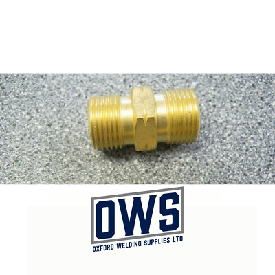

I've finally got around to adding a quick release connector, I didn't want to cut the original gas pipe so I found this adaptor to make use of the existing screw threads:
I still have problems with my original set up coming loose so am going to try this upgrade. Can I ask where you got the quick release part from and other parts?

One of the other advantages, because the Regulator and tap is 1 unit you avoid the problem of having to get the OEM tap and regulator in the correct position to avoid fouling and jamming the gas locker lid. There have been a few posts in the past where owners have had the lid jam. Not easy to resolve without damage.

I have just done the above modification exactly as Brian's Dad (thank you). Really pleased as it make the gas bottle removal so much easier, and reduces the risk of damage to both the lid and water tank from the rather more awkward regulator set up which VW supplied.
I have left the original regulator setup laid flat in a sock above the gas bottle, just in case on continental trips (in particular in Germany), some inspection occurs and the modification is not approved (though I cannot imagine why that would be).
I also bought some (battery-less analogue) 10kg 'suitcase' hanging scales off Amazon so that I can check the gas bottle fill status. In round terms for a Campingaz 907 (or Leisuregaz 007): 6.45Kg full and 3.75Kg empty.
