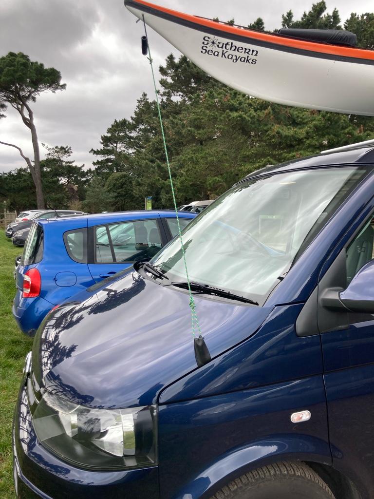

A good practice (which I admit I don’t always do) is to have a rope from the bow down to the towing eye or other attachment point. my boat which is a m shorter than the one shown I have made an anchor point either side of the bonnet to form a bridle. A loop of webbing that is fixed via the bolts that hold the wing on, thin enough to come out of the gap between wing and bonnet. When not in use can be folded out of sight.
Like this, with the rope taken to one on the other side as well.
