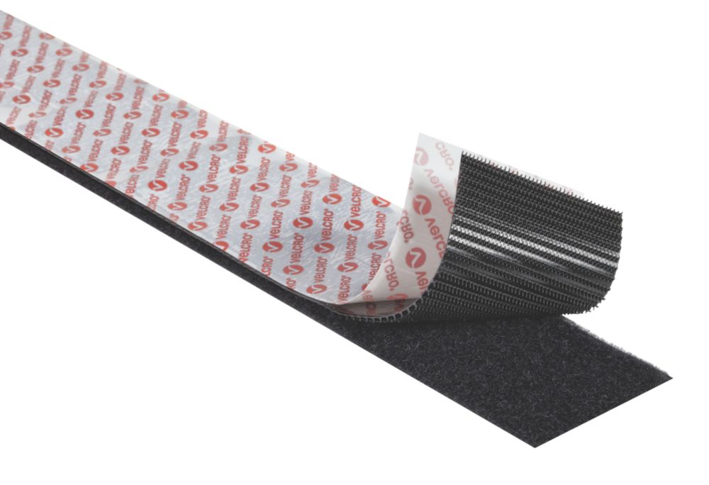

Despite running the heater and getting the temperature up to 29!! I decided to get some cheap velcro as a temporary fix until summer. If it holds great if not I will use the 3M fixings when conditions are better.

Screwfix sell the wide Velcro with self adhesive backing:

I managed to get the inside temperature high but only whilst the heater was on. I think it really needs to at ahigh temperature fora while to get the adhesive to bond. Also the ally frame was probably not that warm.
What do you mean by the 3M fixings?
The loop fixing supplied with the Isotop is made by 3M rather than Velcro. I believe 3M is a higher spec so is probably better but needs more care when applying.
