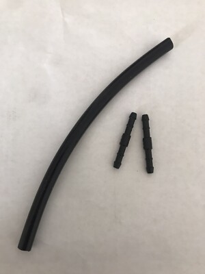

Hi everyone, we've bought our first Campervan T5 SE 180 2011. I've got it booked in to replace the leisure batteries (Varta LA80s) and need a new rubber hose for the passenger side washer just which seems to carry a small split. Only one more thing, the spare key it was supplied with starts the engine but doesn't seem to be paired/communicating with the Van. The red LED shows when pressed. Been assured it was THE actual spare key and see no reason to disbelieve. Is there a short cut to re pair the key if it is indeed a genuine original spare? (Not sure how it became unpaired in first place).
Happy to take to local gargage but thought I'd check first - Thanks guys! :)

Brilliant thanks so much - the split seems to be right on the corner above the level of the bonnet which annoyingly squirts passers by!
Yup, exactly as mine was! 18 months on and this kit is still good.
+1 for that kit - simple and has worked well for the year or so.
