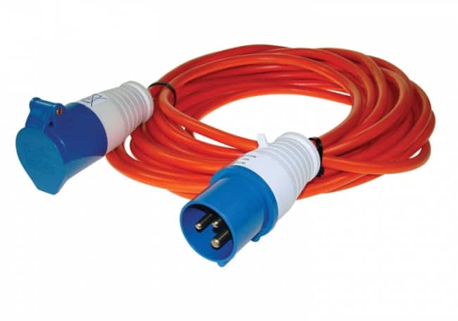

So I have a couple of questions regarding EHU cable -
I had one of the Orange type cables, the connectors seem inferior to the supplied VW short extension one, but what type of cable is used on this one for example, is this PVC or Arctic Flex?
I recently purchased a 2.5mm 25m H07RNF cable but it's so bulky I wanted to know if I could just purchase some of the Orange cable (As per link) and reconnect some Mennekes connectors as these are more robust?
Could I go for a 10m and 15m 1.5mm cable so I have the option of using 10m, 15m or 25m (when called for?
Thanks for any help given, as I do not know if I can use 1.5mm over 25m distance. Only the standard fridge/lights/phones charging are used in campsites?

Can't advise on the cable, all I do know is the narrower the cable the bigger the voltage drop over distance. Having said that in Europe many just use domestic, black rubber cables, and some of them are very long and look quite fragile.
I do have a 15 and 10m cable and normally just use the 15. Only in Europe have I had to add the 10.
Generally everyone uses 2.5mm because that’s just the norm.
Unless your running some big loads in your van like a kettle or fan heater then volt drop won’t be an issue with a 1.5mm2 cable.
You could potentially run into issues with breaker sizes being inconsistent with 1.5 but then you’re covered on disconnect times via the RCD.
1.5mm blue Artic flex. Crack on.
@WelshGas thank you. It is mainly in Europe that I would be using it, and have found needing the longer cable. But wasn't even sure if I had the 25m H07RNF 2.5mm cable, if I could still use the VW Cali supplied 1m 1.5mm H07RNF 16A connector to 2-pin EU plug, as some sites you need to use the 2-pin plug ?
Seems to me that I'm finding anything over 10m or 15m it looks like the larger 2.5mm cable is being used.

Some campsites we have been at demand a point to point hook up cable with no joints. I have a few different lengths of cables (6, 13, 25m) which I use as required, but some warden's get upset with commando connections and a discussion on IP ratings, so I can imagine a Euro plug might also get them upset.
