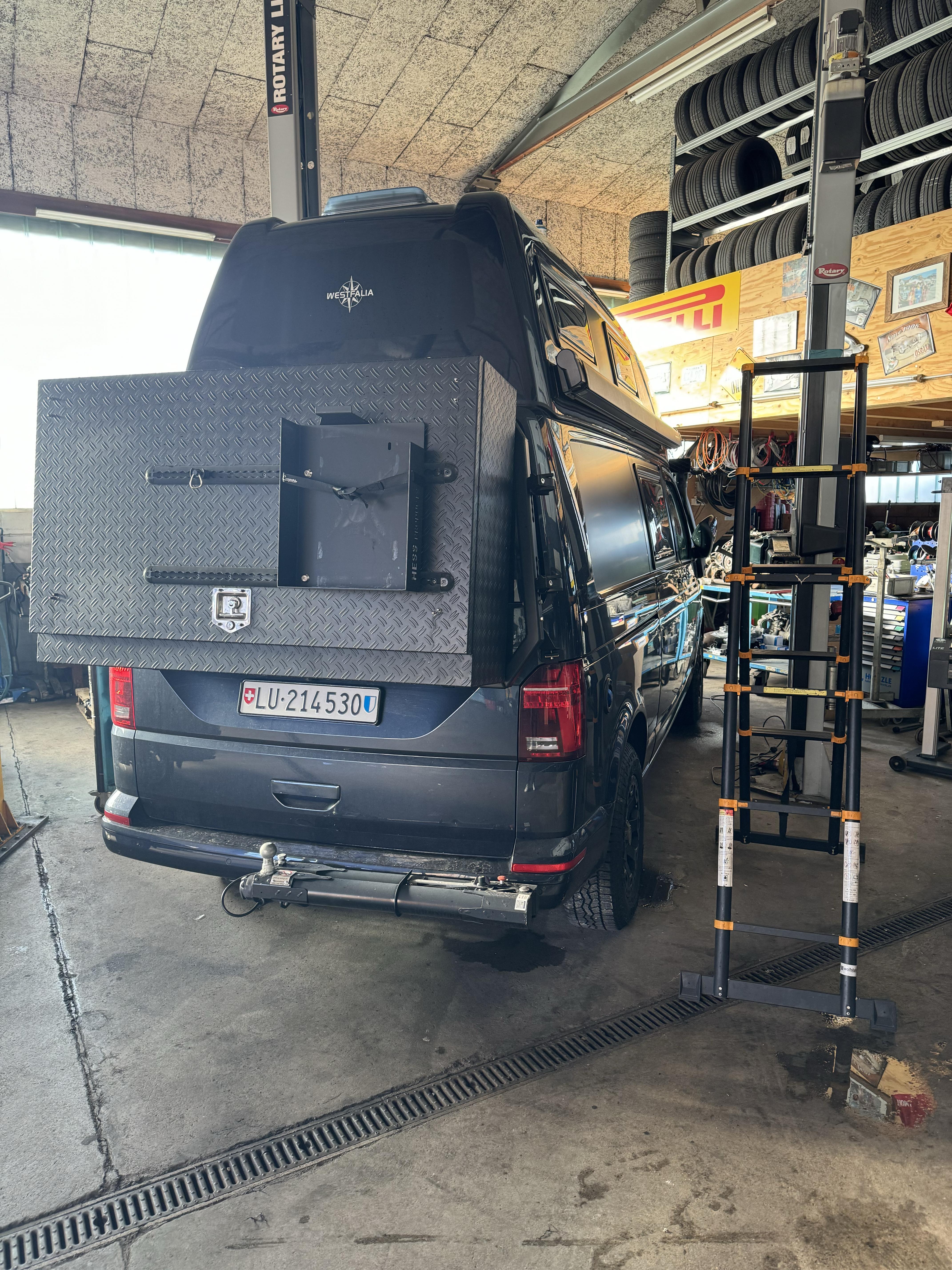

I also did another mod I will take a photo of tomorrow and share. I had my mechanic modify my air suspension to add another air hose with shutoff valve and a quick connect for an air hose under the bonnet. I can now quickly attach my ARB air hose and tire guage and quickly adjust pressure easily using the compressor I already have onboard. It has a large air tank with 15 bar of pressure so inflating is crazy quick! Bonus is I can also attach an air pistol and blow off/clean dirt debris and water after washing. Super stoked he made that happen! Parts were fairly cheap and it took him about an hour to do.
I like the sound of that. Another reason for me to look at air suspension! I’ve been very happy with my Bilstein suspension set up but like to be able to change ride height and self level the van. VB is the only real option here though but it runs a similar size air tank to your set up I think.
Mod can definitely be done with VB too. One of my favorite things is pushing the auto level and I’m setup for sleep in less than a minute. Also more important in my case with a shower to ensure the van is level and the water goes down the drain instead of a slight slope and having it flow into the cabin!
