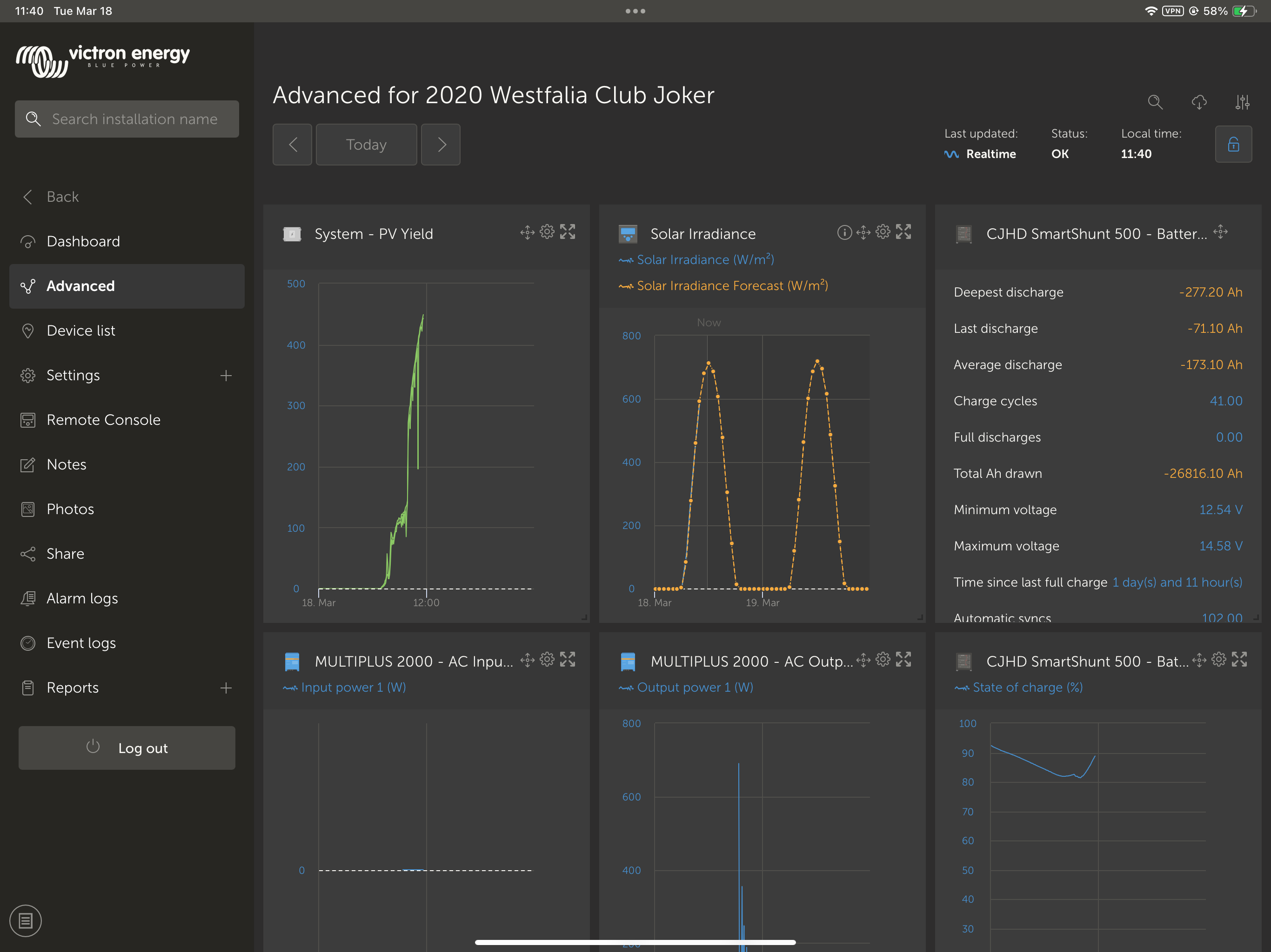

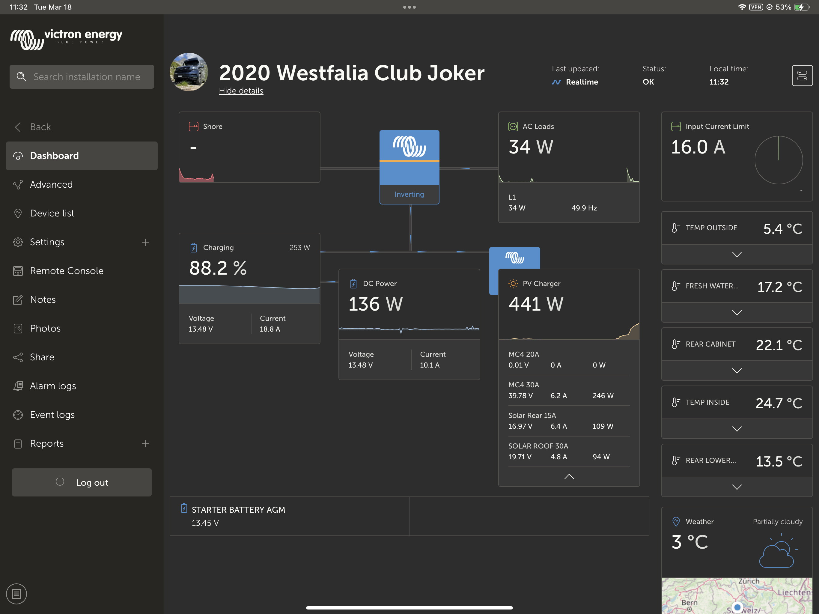

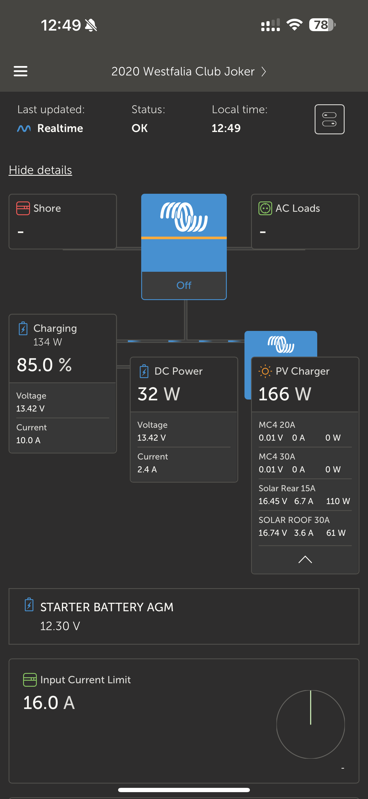

It’s now solar noon without clouds. As the Winter sun is low in the sky this test proves that the rear and side panels were worth it. Double the power va the flat panels on the roof. So far so good!

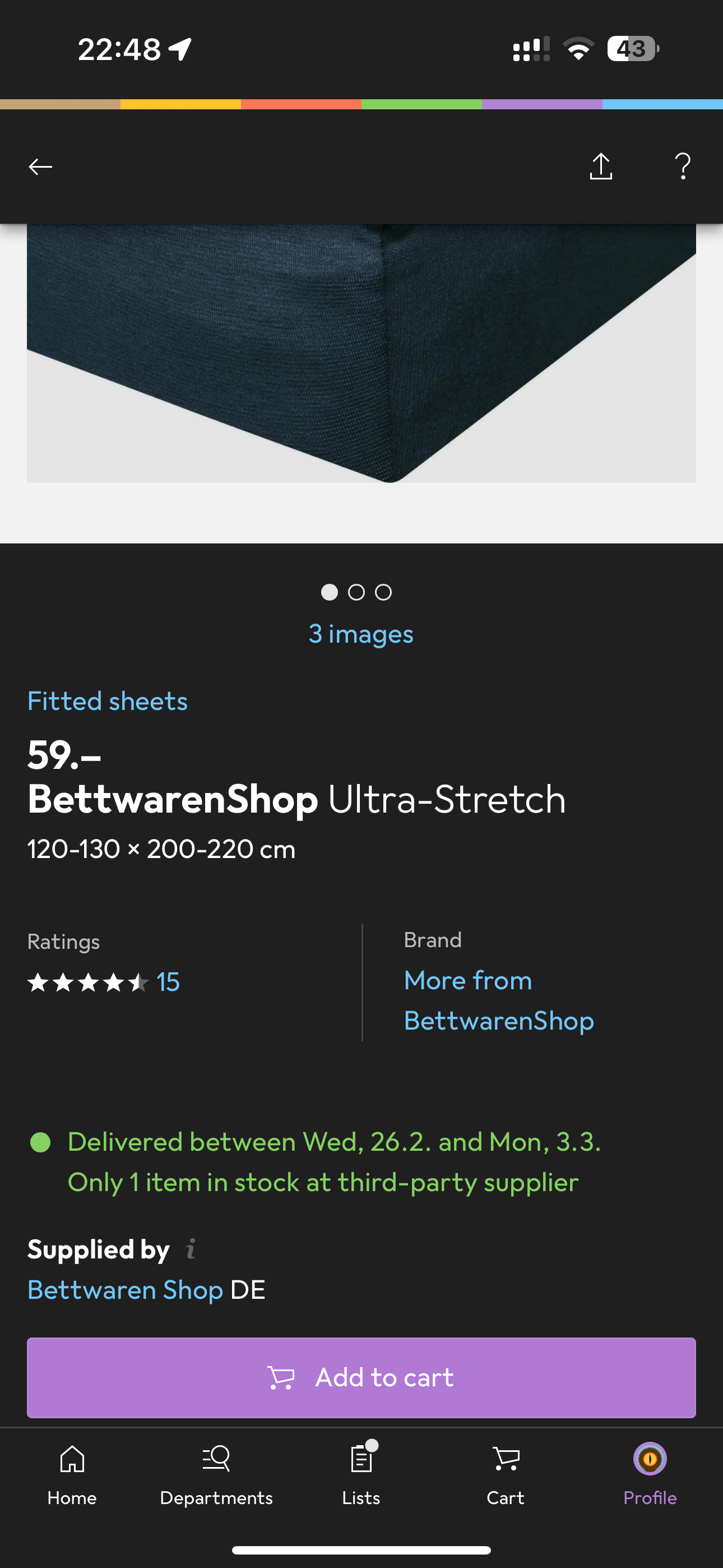

Hey Webbah...enquiring minds want to know...well maybe just me enquiring...how do you handle the penthouse mattresses, have you found someone to source fitted sheets for each section of the Froli mattresses or, like me are you using a topper on top of them?
Haha! The struggle “was” real. I took measurements and found fitted sheets that work. Bought 4 of them and rotate. Some are cotton for summer and some are thicker flannel type for winter.

Sun is shining! Finally solar irradiance up to 700 or so. Great for another test of the new panels.
