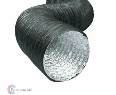

Like some others here we have a 4" flexible hose that I clip to the heater grill and run upstairs. This heats the coolest part of the van overnight and those downstairs benefit from the residual heat. We generally use our home duvets and haven't had any issues with cold.
We went down the heater tube route as it was both cheap and completely/easily removable for summer. Here's hoping the T7 has a variable control to route some of the heater air up top!
Do you have a photo of this tube/redirecting set up by any chance please? I'm sure I've seen someone on here post theirs in the past, but for the life of me can't find it now.
There was a whole thread on it but I can't find it despite numerous searches. Must have been archived off, which is not ideal for trying to find useful content!
Will take some pics next time I'm in the van, perhaps the moderators can find the thread in the meantime?
Should still be available somewhere, we rarely delete anything.
