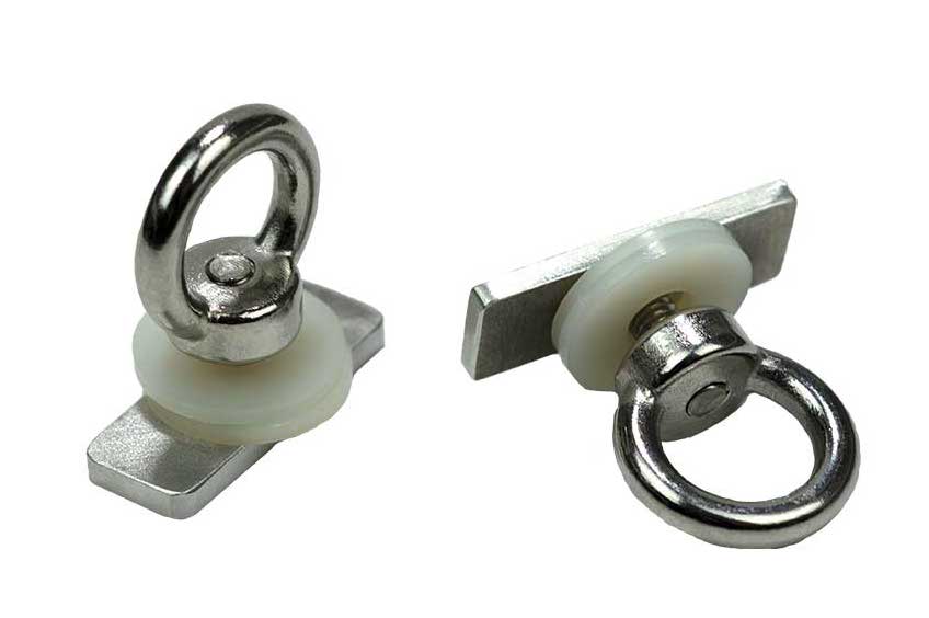

Are these any good
Thanks, was hoping to avoid plastic if possible, quite like the strapping type or metal really. i think they might be stronger. Waiting to try something in the section to see if its 8mm or 6mm, I have a shade i think that fits, so i can sure of sizing, but am suffering with broken ribs after a mountain bike accident so, having to take it easy! :rolleyes:
