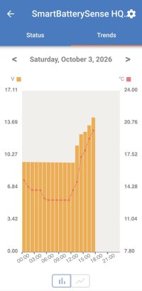

  • Kayleigh
    Kayleigh replied to the thread T6 Beach leisure battery not charging.
    Current leisure battery status with the engine running on tick over, heated windscreen on and still plugged in to EHU. Unplugging from...
