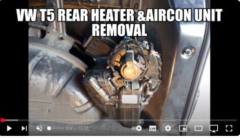

The T5 & 6 are the same.
There is a lot behind that trim panel.
And a video to show it being removed.

Hi WelshGas,
Having watched video it sounds as though the only item behind the air vents is the AC metal ducting pipe. If a retaining clip has come loose that may account for both rattle and vibration.
For clarity it is from behind these air vents that rattle / knocking is coming from.
