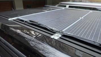

If you are interested in installing solar panels, you can see that I can get three of Roger Donaghue’s panels on the roof and still have room to install roof rack feet. https://www.solarcampersolutions.com/

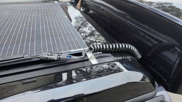

Wire drops down next to the rear door hinge and through the grommet now conveniently installed to route the wiring behind the cupboards.
I now leave the fridge on permanently and the leisure batteries are fully topped up by 10am even if I have run the parking heater and air con the night before.

That installation looks fabulous and seems like a real value add. Can I ask, do the panels top up the vehicle battery when the leisure batteries are full? If not, what is your experience with the behaviour of the main vehicle battery when in camping mode? Mine looses it charge frustratingly quickly, down to very low levels after two nights camping. I have read the advice in other threads and am careful not to use the front doors, to turn off keyless access etc but I am struggling. There seems to be a constant draw on the main batter of 5-8 amps according to the central control panel.
I had a 3 panel setup on my T6.1, it was awesome. Kept the fridge running permanently, interior lights, chargers etc & topped up my Ecoflow Delta to run 240V accessories.
It’s for sale at the moment, with Victron MPPT etc. same roof track dimensions on the T7

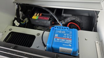

I was intending to have the “Duo” charger which is an MPPT with a 1amp trickle charge but we couldn’t find the starter battery without disconnecting the front seats and my experience with other vans means that you often get an airbag fault on the dash that needs a dealer reset.
I see the same challenge with the starter battery dropping amps on the display but so far I haven’t had it sit for longer than four nights, in camp mode, without restarting the engine. Like you I’m careful to not use the drivers door and lock up without using the remote, so far I haven’t turned off keyless entry, but I am careful to turn off the Infotainment system as I have noticed the Bluetooth on my phone remains connected and I am not convinced the system goes into low power mode when connected to your phone.
I have a jump start lithium pack in the glove box just in case.
I may install a split charge from the leisure batteries if it becomes an issue.
I really recommend getting these solar panels and if anyone is interested they are still under 2m total vehicle height (by 1cm!!)
