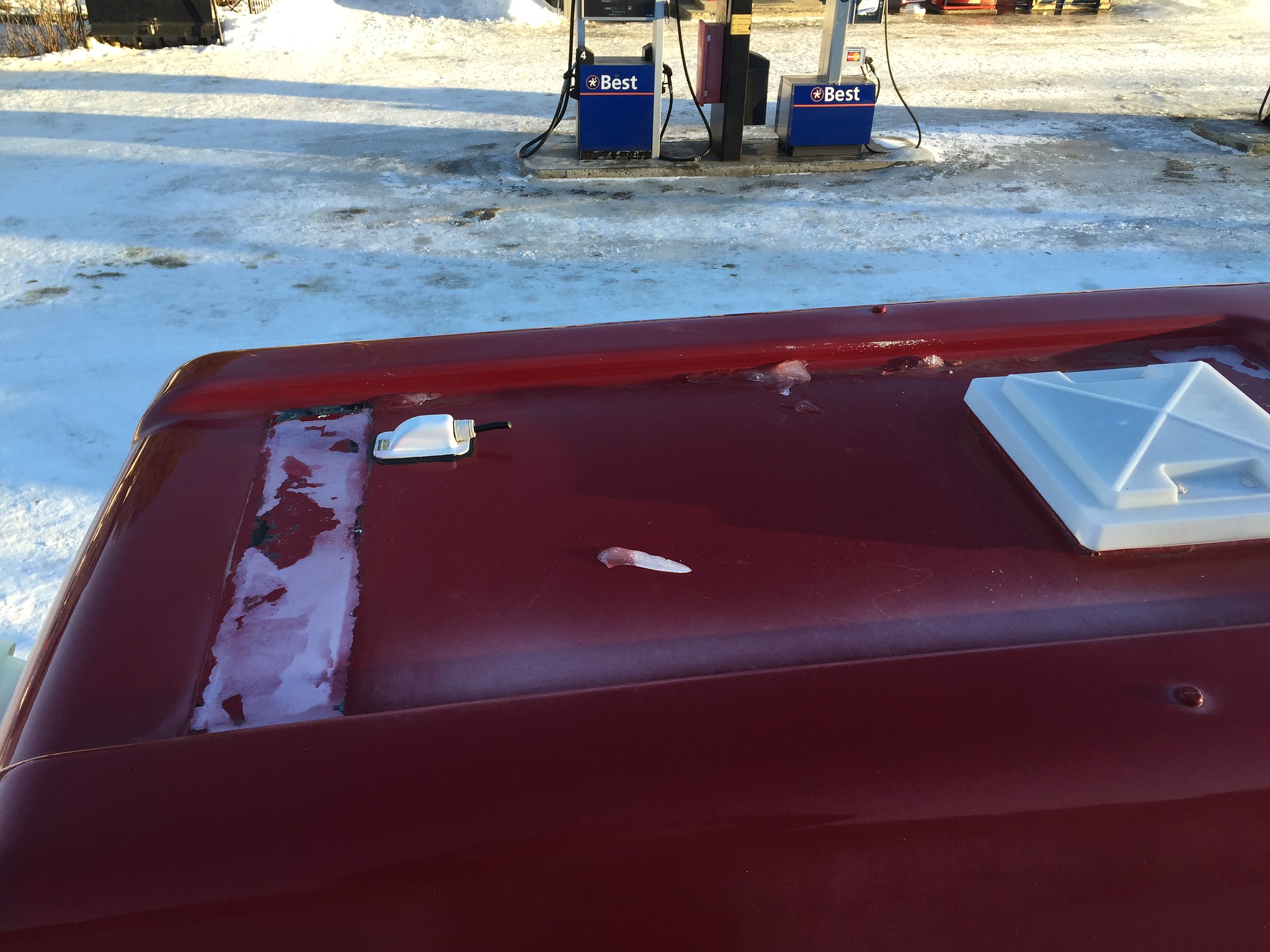

I'm just wondering how other high-toppers have their solar panel set up? I'm just looking at putting one back on. The last owner looks like he's pinched the panel but left the controller and wiring. I'm looking a single 140-150w panel but I wondered how anyone else has got on with bigger or smaller panels?

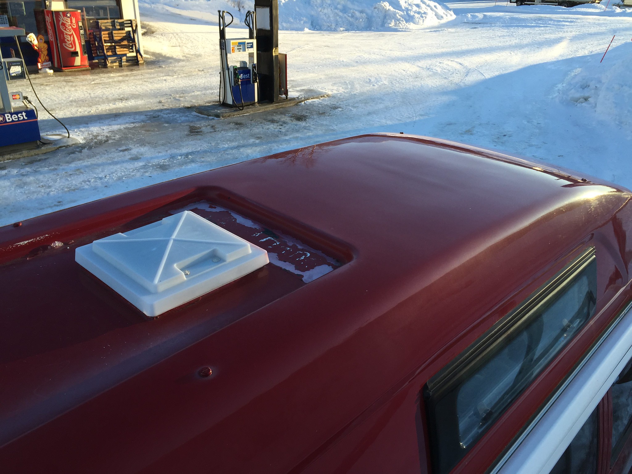

Cheers, That looks very tidy indeed. I'm still working out what size panel I need or want. The inner kid wants the biggest but then I think about how often i'll need it. I was up on top measuring up today. It looks like the old panel went over the pop-up vent which seems a bit daft. The suns up all day in the summer so I'll go more juice than normal fingers crossed :)

Aye, I can get a rigid 100W panel to fit in the gap just fine. I dont think i'll need owt beefier.
Matt, It appears your 3rd break light has been removed (?) so you will be able to get a bigger panel on.

I wasn't sure if mine ever had one. Mines the older model with green dials rather than the funky newer blue dials. I can't see any holes or marks for the third brake light. There's a few other things it seems to be missing.
Good idea to re-use an old hole. The less holes the better.
