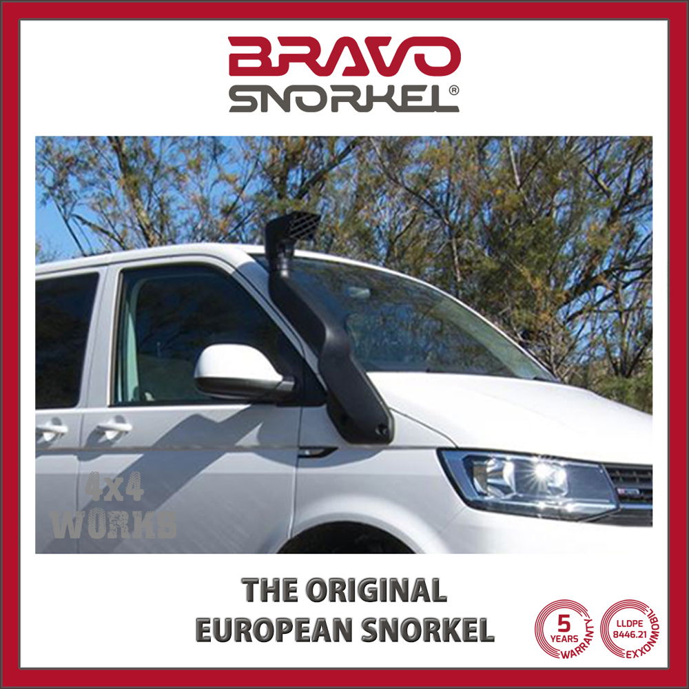

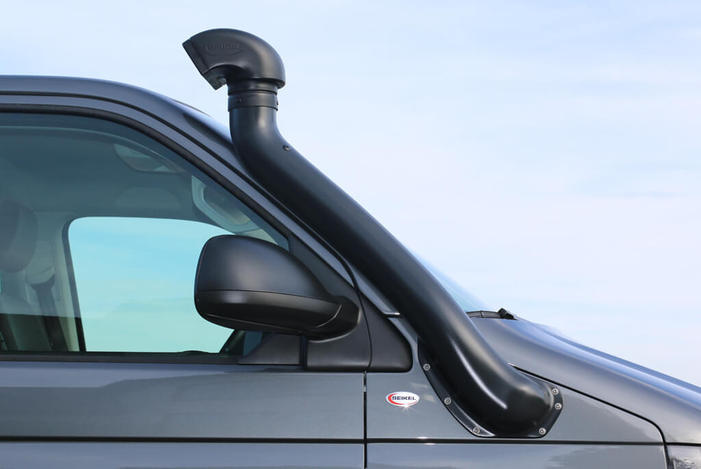

Hi, welcome.
When you mention snorkels, is it for increasing wade depth?
Usually a higher air intake does get confused for a snorkel. The terms do get used interchangeably. The higher air intake only helps to get cleaner air into the engine air filter.
See the below. for a higher air intake. It is called a snorkel, but is technically not a snorkel in the true sense of the word.
or
If you are planning to increase the wade depth, then you need to manage the vents in the gearbox and the diff. then you need this - https://www.seikel.de/shop/gearbox-vents-for-greater-fording-depth-kopieren/?lang=eh

I have the Brava snorkel and the Hess Products wade lifting kit for the differential and gearbox vents. I opted to not do the standing heater and water boiler (Club Joker) as these will work fine once they dry out.

I brought a van 150 with a Bravo air intake already fitted, they do make a fair bit of noise as it sucks in the air, sounds like a wheel bearing going,
Also if you have or need an exterior thermal cover it will need adapting.
I wouldn’t fit one because of the noise, be warned
