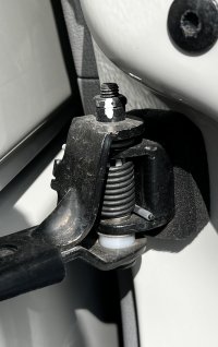

I have had trouble closing the sliding door on my Ocean 6.1. The door seemed to have dropped and was not lining up with the catch. I have taken a closer look and used an allen key to tighten up the bolt from underneath. It now looks like the second photo, does this look correct or is there something missing?
there is a nut missing from the top of the threaded part
Take a photo of the top and
bottom roller
And a photo of the gap around the door when closed.
If the door drops it will damage the bodywork (mid rail ) where the centre hinge hits the bodywork on closing.
Thank you for photo, as well as adding a bolt (which I think has been missing from new) I might need to tighten a bit more as I have more of the white showing underneath the spring,
Is this better?
It's about 14mm from the top of the bracket to the end of the thread.
