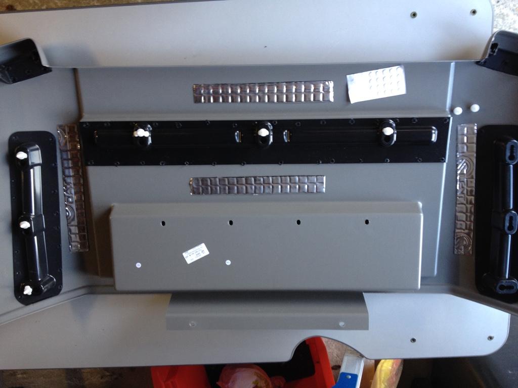

At the moment, the plastic cover under the rear bench is slightly unclipped at the bottom, and I would like to try to remove it properly, like in the picture. Do any of you know the safest way to do this without damaging the cover? Which tools would you recommend? Even better, if you can share a tutorial video, I would really appreciate it, as I haven’t been able to find anything relevant online so far.

Its many years since I removed the cover of the seatback (and my Beach is different to the SE/Ocean, as no flip down headrest or toolkit) but from memory its held on via various trim clips.

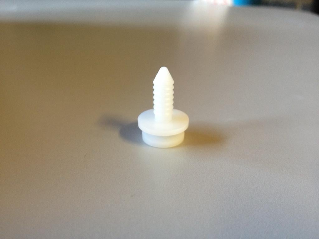

Some you can see from the outside: these appear to have an allen key hole but I have never managed to successfully unscrew them. Least damaging is to screw a small self tapping screw into the hole and the physically pull the plug out with pliers or mole grips holding the screw.
Then there will be some trim clips you cant see, these you have to pull away. In the photo posted by Colinfcolinf above you can see 6 small white circles (3 each side). Think these are the sockets where the plugs locate into.
Found a photo of the back of the plastic cover.
3 clips each side and 3 along the top.
The clip
