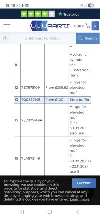

Aside from VW and maybe the driveways of owners, would anyone happen to know where to find replacements?
I found both of mine loose in the channel below, soon after purchase new. I replaced them as per the #1 posting with some adhesive - plus I put a smear of silicone grease on the facing strut.

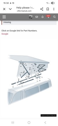

There is another thread with the link on, I copied these.
I hope it helps
Ali express seems cheapest, you'll need to diameter of the hole it fits and do a search on Rubber bump stop
