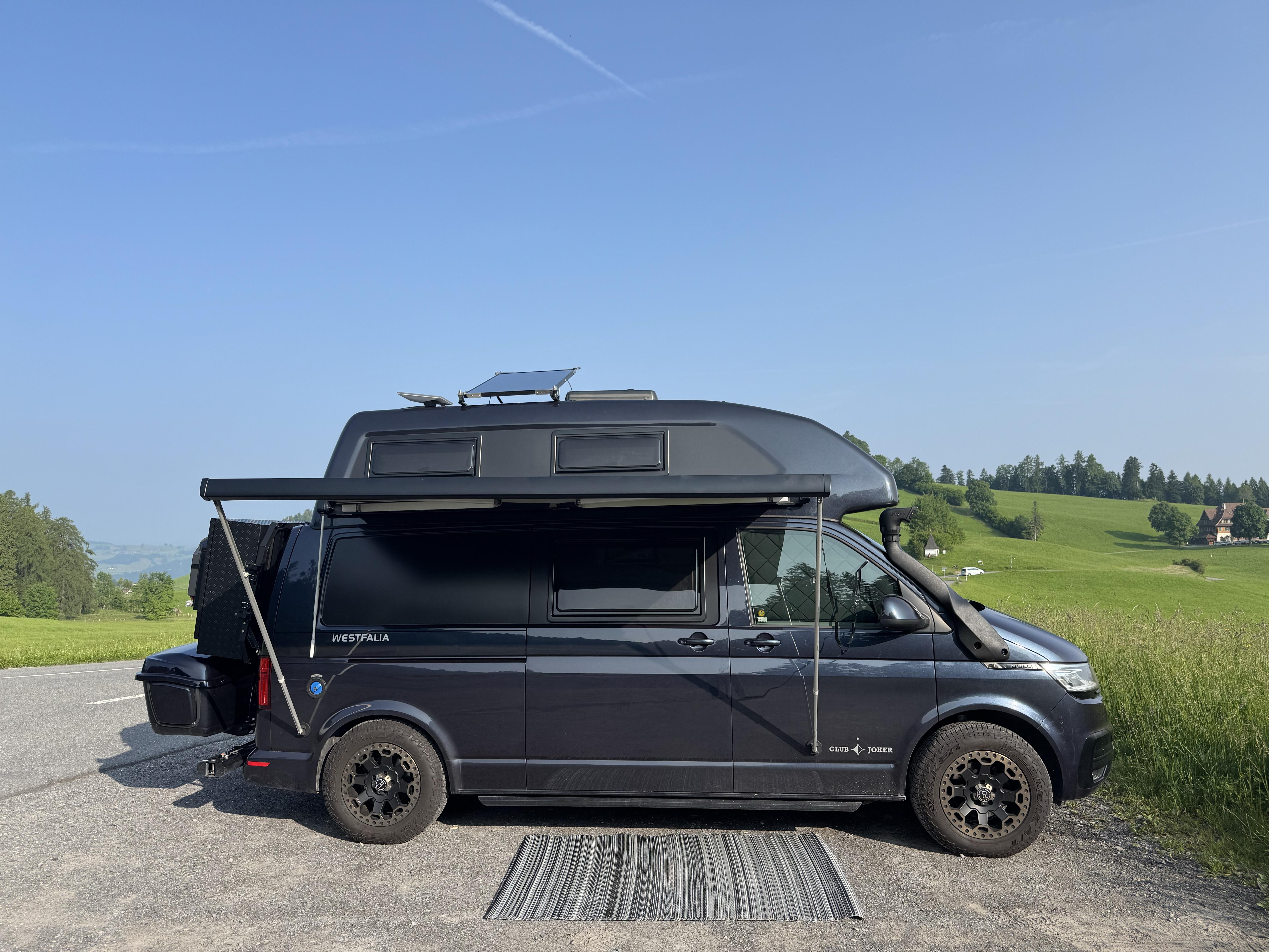

I use these. Absolutely love them! Ability to use the awning anywhere including when parked up with tarmac/pavement. Really locks in the legs and allows you to tension the roof. That said, if it is really gusting wind I'd want to use the storm straps as well, but I've had my awning out in pretty heavy wind without them and not had an issue. Also great if pitched up in grass, mud, sand, etc. No dirt on the feet of the awning to deal with.
interesting... if you get a chance can you share a pic of them in use :)
Here ya go
