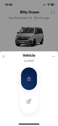

Given you can unlock a 6.1 using the Volkswagen app, being locked out is less of an issue. Starting it would remain one though, if you’ve lost your only key.

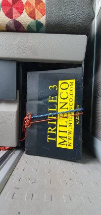

I don't have the extra drawer under the rear seat and I'm pleased that I don't. Why? The void is the perfect size for a set of Thule leveling ramps, so, when we arrive on site we can whip the ramps out from under the seat without rummaging about in the boot, level up the van, then get on with setting up camp.
I agree with Simbo on this. I have Milenco Triple 3s which are quite bulky, but anything less than 120mm is not really giving much levelling. I'm generally a minimalist but use them more than I expected from reading the threads here. I would sacrifice a lot of boot space if they weren't in this handy spot. They do protrude through into boot, and in my case I made a custom storage box to optimise the boot arrangement.
Exactly what we use the space for too!
