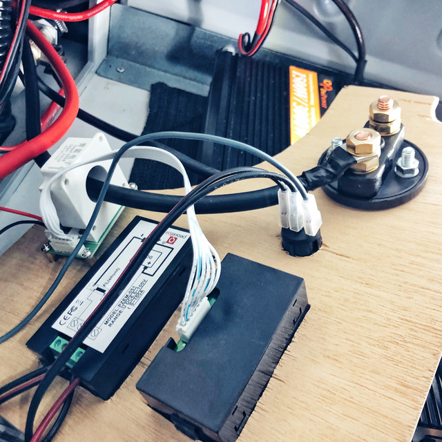

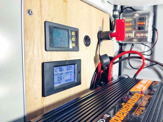

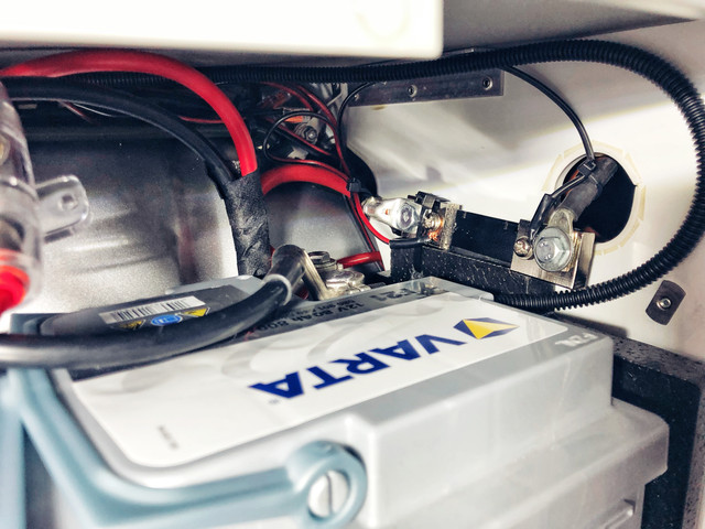

With all the reading, including excellent info by WelshGas, I decided to order a few parts and add to the installation, to hopefully have greater control over the batteries health.
Seeing as the rear earth shunt is what closes the circuit for the whole leisure system, I'm going to add a cut-off switch in between the shunt and the rear battery. Also in between will be the amp meter, one on each of the battery's negative pole.
I ordered big red cut-off switch, 2 AWG (35mm2) cable, two amp meters and a fuse box.
I will mount the cut-off next to the water drain valve, where I already routed the cables for the inverter, that way I can switch the whole system off when not in use, assuring there are nothing drawing power.
The amp-meters will allow me to know how much each battery is outputting.
The small fuse box will allow me a tidy connection point for any future upgrades.
Anyone ever do anything similar?
Well, managed to install all of this before the weekend trip.
It works well but I'm going to rewire the power meters so that I have one for each battery and one fot the total.
We were wild camping, so of course no hookup, only charged when engine running, but even so, yesterday battery voltage was already dropping to 12.2V under load. That's only with fridge running on level 3.
