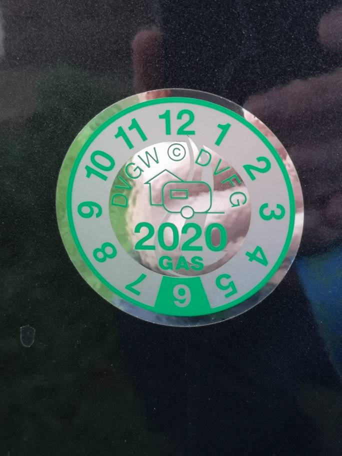

Hi all. I presume this sticker has something to do with the gas system installation. Is there any need to display it?

Others will help, but I think it's the date when the gas system needs checking (June 2020). It's 2 or 3? years from the date the van was built

It's the TUV sticker for Gemany only .
If you had registred the Cali in Germany you would be ok until 6/2020 before needed new gassystem check

On tailgate of our Cali - can I remove it?
It is a certificate that the gas system is good until the date displayed.
You don't have to check the gas system before june 2021.
After that date, or just before that date, you should need to have the gas system checked for leaks.
If everything is alright, you can receive a new sticker, with a new date (2 or 3 years?).

Oh, and the flexible hose from the gas bottle to the fixed line in the van has an expiry date too. There will be a label that says the expiry date.
This has to be changed before, or on that date.

Yes, and a new gas hose and regulator required after 10yrs.

Nobody as such, although a caravan gas fitter would do it for you. The rubber gas hose in the bottle locker has a date on it when it’s due to be changed
Thank you so go to a caravan shop that sells gas will be the best answer, by the sounds of it?
If you want it fully and officially checked, you need to look for someone in your area that does "habitation checks" on caravans and motorhomes. Be aware that most of their time is conventionally spent checking for damp (unnecessary on a Cali) so I'd be looking for a big discount on their published price (but appreciating that they still have to do a call out)
