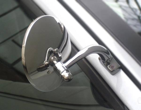

You could get one of these, attach a piece of thin plastic to the bit that is meant to stick and just wedge it in the upright of the window frame........
Failing that, there are cheaper versions of this type of mirror...........
