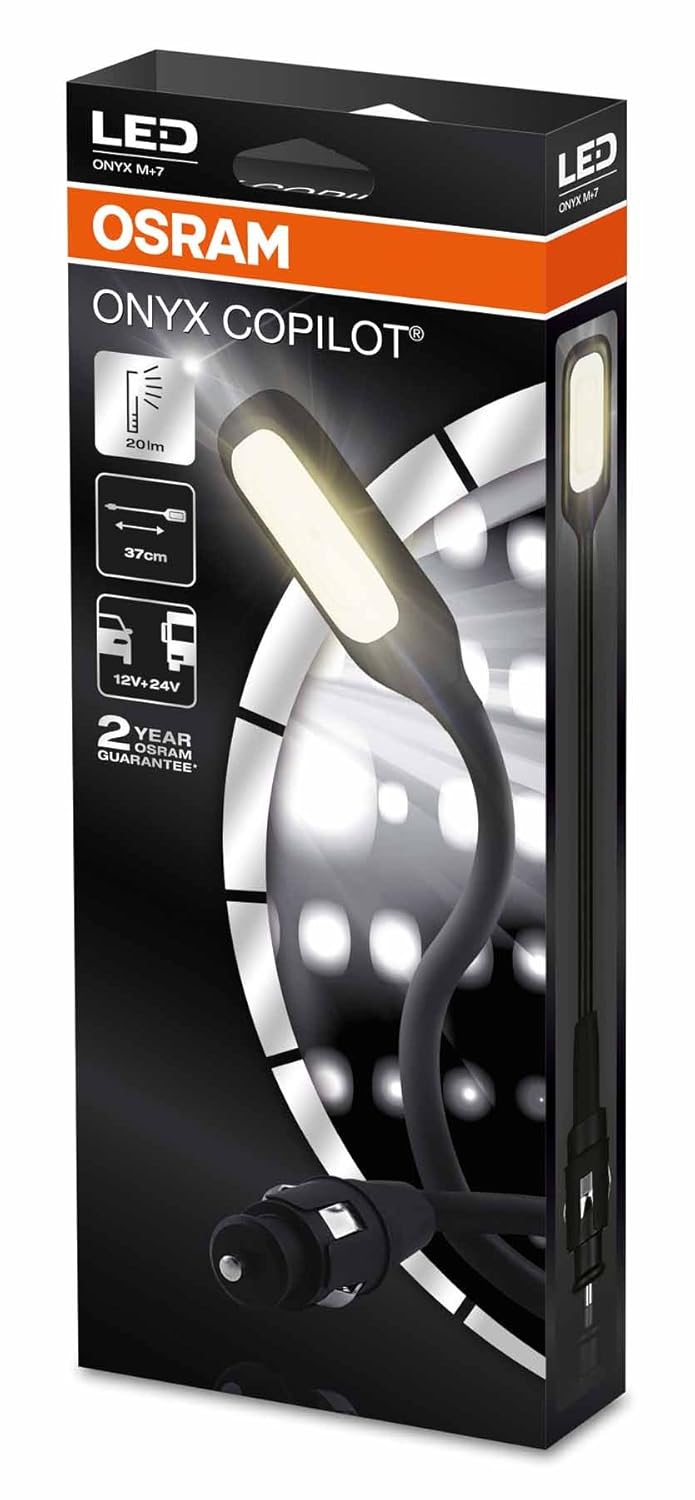

Here is a very nice replacement, easily installed yourself: the Osram Onyx co-pilot:

It is fiddle as the Lamp plug will go through the hole in the metalwork but the socket, into which it plugs will not come out of the hole ( too big ), so with care yes.
If you use a 3rd Party replacement, such as the Osram LED, then dismantle the old light, DO NOT unplug and then cut the wires in the old lamp and splice/solder or use connectors to fit the new lamp wires to the remains of the old lamp wires. Insulate and push into the hole when re-fitting lamp. Fairly straight forward really - if you can wire a plug etc:. Remember 1 wire will be live as you do this unless you remove the fuse. Please don't ask which fuse as they can vary from vehicle to vehicle but it could be a 10amp fuse under the Left seat position 18, or not.
Well, Amazon is not such a bad webshop, Wim... Little risk there!
