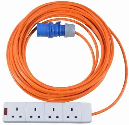

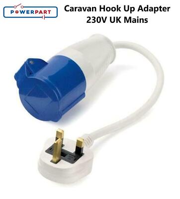

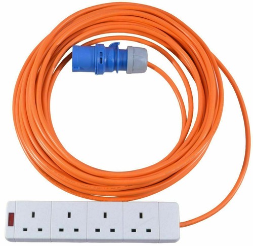

Thank you. What do you use to mains charge please? Just the same as a hook up cablemwith adaptor?
This (delivered with your van) and whatever you need to connect it to the mains.
Thanks - totally newbies as you can tell
The one @TripleBee showed is the European adapter. Same blue socket but with a UK plug. Plenty on Amazon and eBay + the 10,15 or 25 m orange cable you would use on a campsite.
I don't know what cable is delivered with UK californias. Mine was delivered with the one on the picture (although with a longer lead).
You could also opt for a 25 meter cable with UK plugs, or a set of adapters. Depending on what you will need most.
Exactly the same as the one you showed. Useful for some of the older European sites who haven't upgraded to the modern blue plug/socket system but no use in the UK.
On the other hand, that one is mostly too short to get to the socket anyway. I always carry a cable of 25 meters with me, and an adapter from EU plug to CEE.
Yes, you still need the longer cable. It's just an adapter really.
These 2 leads.
