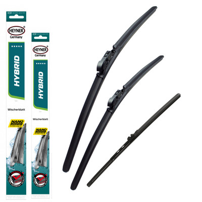

The Multivan has been out since 2021 and the only blades I have found to fit and work perfectly are as above Post 2. They are a German make.
These Heyner wiper blades are superb. I dumped the original ones fitted to my T7 and couldn’t be happier.
Completely silent and clear the screen far better than the original fitment.
