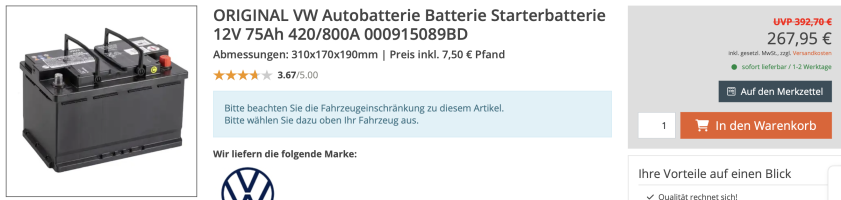

I have spotted these that are available and way cheaper than what you have been quoted, looks like the same too. Screenshot 2025-05-09 at 22.01.50.png

I have spotted these that are available and way cheaper than what you have been quoted, looks like the same too. View attachment 135800

I think I found the website you referred to in the picture. One picture shows the previous number with index CD. One thing you will have to look for if you go for OEM batteries is the date stamp on the minus connector.
My original starter battery had time stamp 44/09. This is the last week of october, and my van was produced in november, so that matches quite well.
If the time stamp of the new battery is over 1 year old, the battery can be already compromised from the start.
