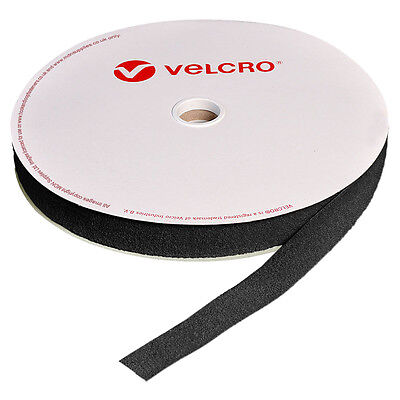

There are different types of Velcro for domestic and industrial use. You would need the Industrial type as the glue used is much more water and temperature resistant.
Went for some 3m Velcro. I’m not holding out much hope for it. Any ideas on some industrial spec stuff ?

Any idea where the glue can be sourced? Our isotop has started to lift as the glue has changed to a sticky rather than suck substance after 5 years! I would like to remove, clean and re-glue it!
I have no idea if you can buy the glue they use separately. Could you not buy a roll of the industrial Velcro from their site and just cut to size?
I got about 10m of this for about £12 which was more than enough. Trying to re-glue sounds like a messy option with scope for nasty spillages.
I did also buy some sachets of adhesion promoter wipes to ensure good stick (a few quid on amazon for 10 sachets). I cleaned the surface before fitting. Six months in and the velcro is still very firmly attached.
