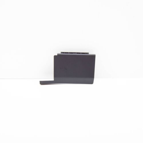

Found in the starter battery compartment (after 3 years of ownership). Part number 7E0 915 4356 BP1050431.JPG
Found in the starter battery compartment (after 3 years of ownership). Part number 7E0 915 4356 BView attachment 117822
sems to be that...
Yep! That's it, but for the life of me I can't see how or where it fits relative to the battery. Presumably the previous owner didn't know either. It's a very expensive piece of plastic that doesn't seem to be that vital given it's just been lying in the battery compartment.. Maybe I'll just put it back where I found it.
Having just completed wiring in a pair of Lazer lamps I had to remove that part to enable cables to be fed through to the battery Area.
On the left of the battery there is an upright shield made up of two or three plastic like plates which connect buy sliding in groves of each other.
Attached on the end nearest the rads and lights is your part at right angles which seems to close off the area to stop any weather/crap coming into the area behind the lights.
if you are still unsure I will try and take a picture over the weekend.
hope this helps.

pic shows the part. To instal you would need to undo the plastic screw at top front.IMG_1102.jpeg

Yes. See attached photo. It fits down the front of the compartment as shown in the parts location diagram in @aeicalifornia's post so not quite like yours: interesting to see that VW have been able to use the same part. Thanks to everyone who responded.
