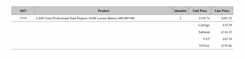

Last year I had a choice of getting roof solar to top up my 16 year old batteries which had been amazing or get new batteries. I didn’t want roof solar, so I did the latter, but perhaps I needed both.
My original OEM batteries used to sit all winter long without ever being plugged in. They lasted 16 years. I’ve owned these Tayna Varta replacements 6 months and they’re already looking far far inferior.
I may connect the panel directly to the underseat battery as the wires came with the panel and resign myself to having to move it to my drive and plug in every 8 weeks or so.
Tayna customer service seem to think 6 weeks without plugging in was a long time. I thought these things were used on boats etc??
