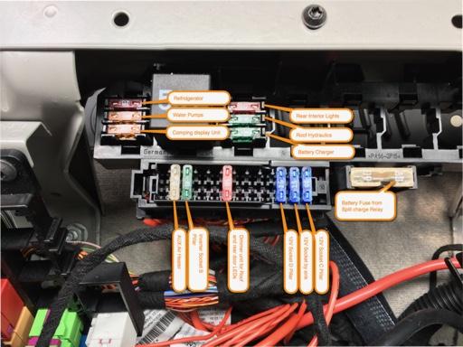

Fuses for under seat courtesy of @Loz

there is no fuse between the RCD and the 13A socket so it might be a loose connection where the wires connect to the back of the RCD, this has been reported before.
