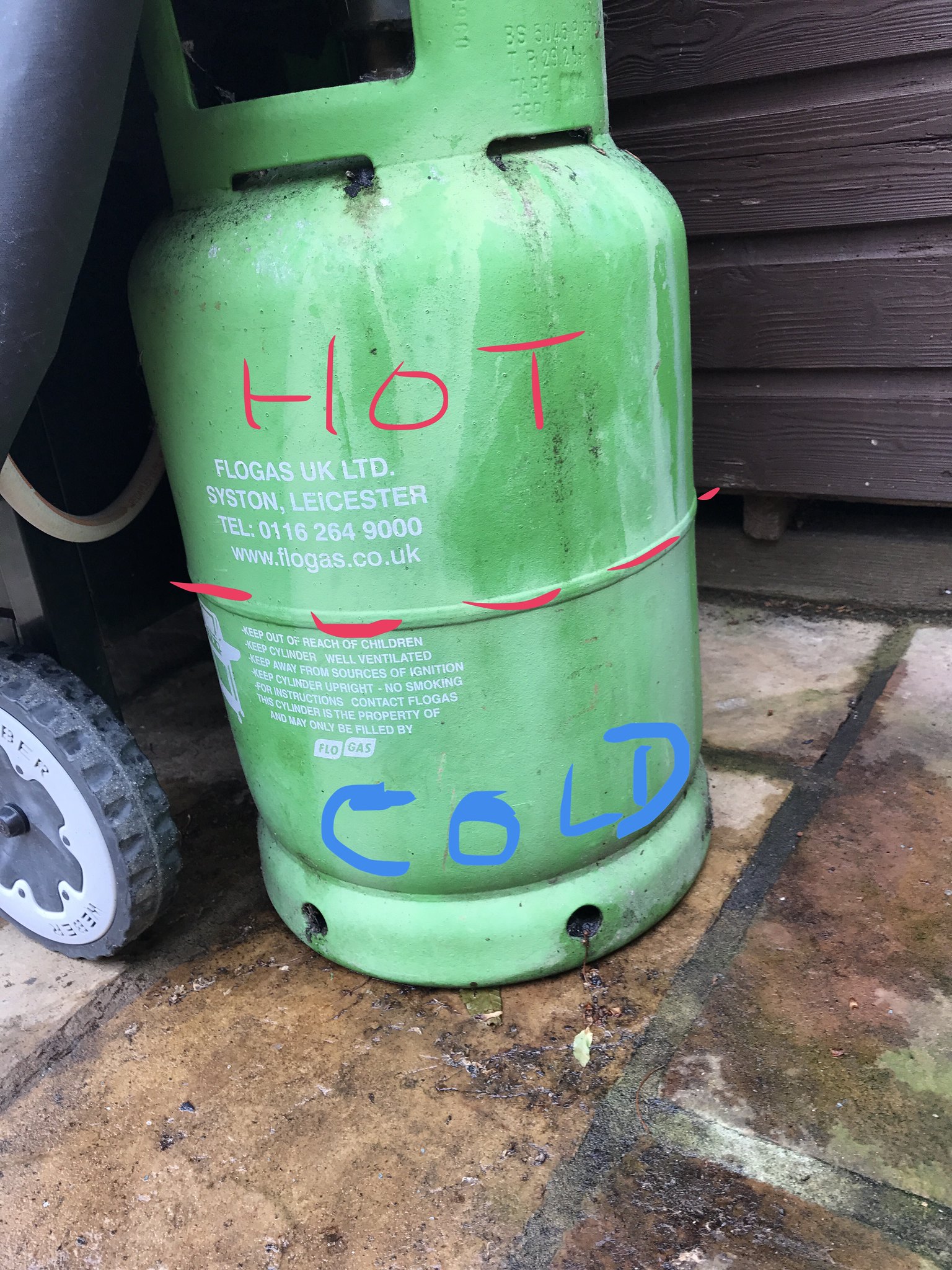

I stumbled across this tip on the internet to check how much gas is left in a bottle, and it seems to work....
- Boil the kettle
- Remove the gas bottle from your Cali
- Pour the boiled water on the side of the bottle
- Wait a few seconds so as to not burn yourself
- Touch the side of the bottle, the metal is cool where the gas is and VERY hot where there is no gas
I've just tried it with both my Cali bottle and the BBQ bottle, and it works a treat!!
